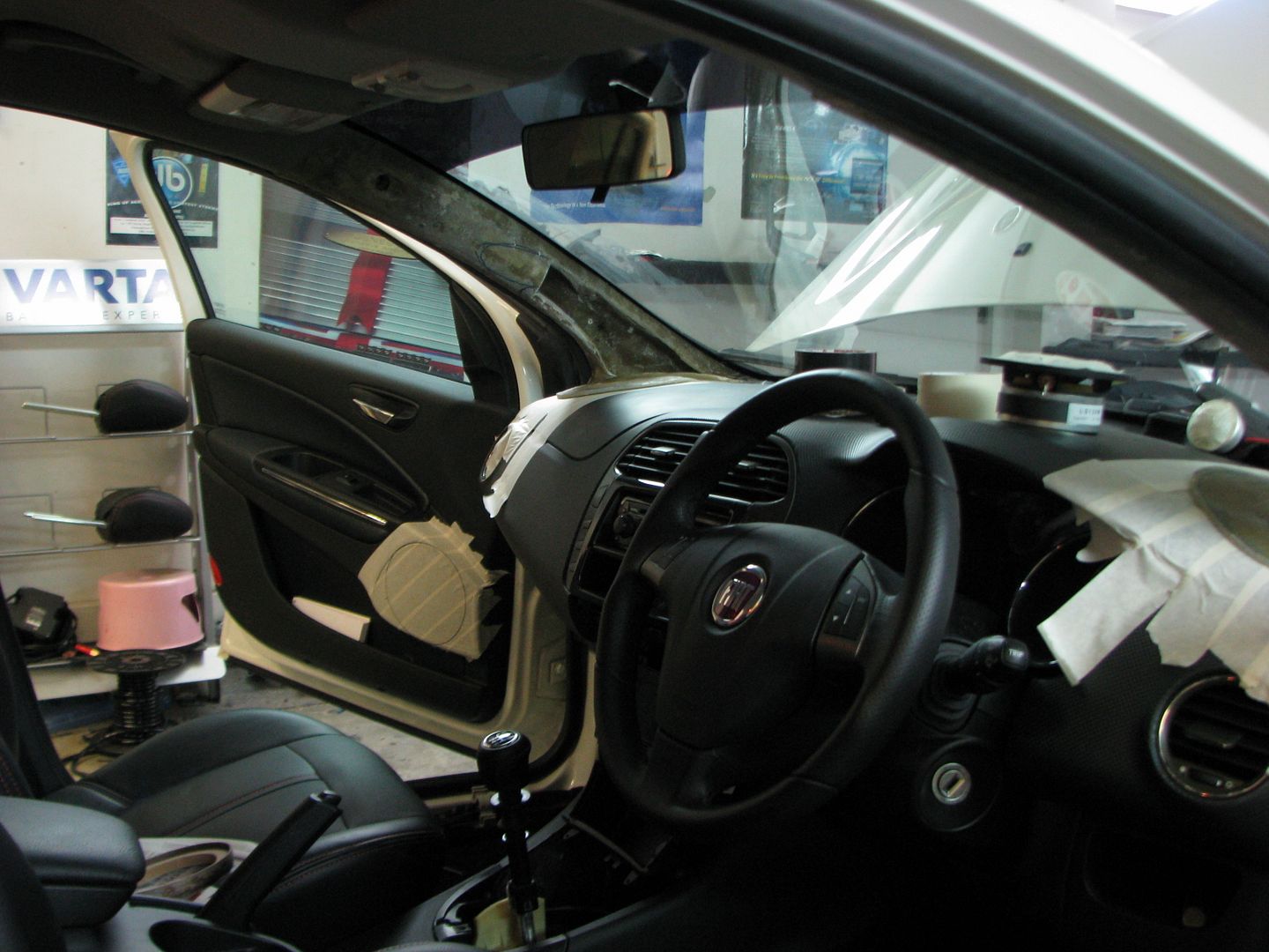

Car was sent for inspection today. So no updates on the car.

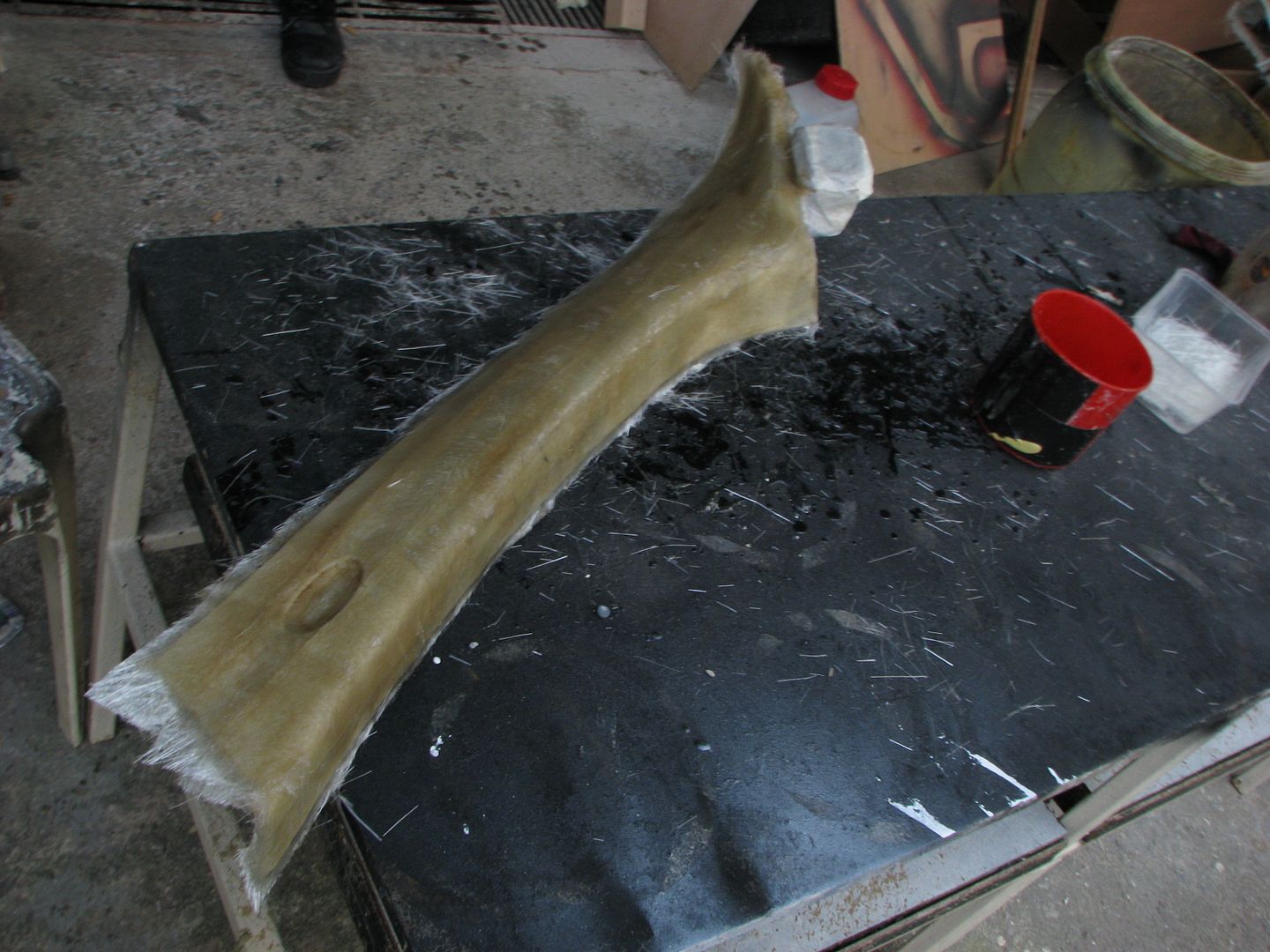

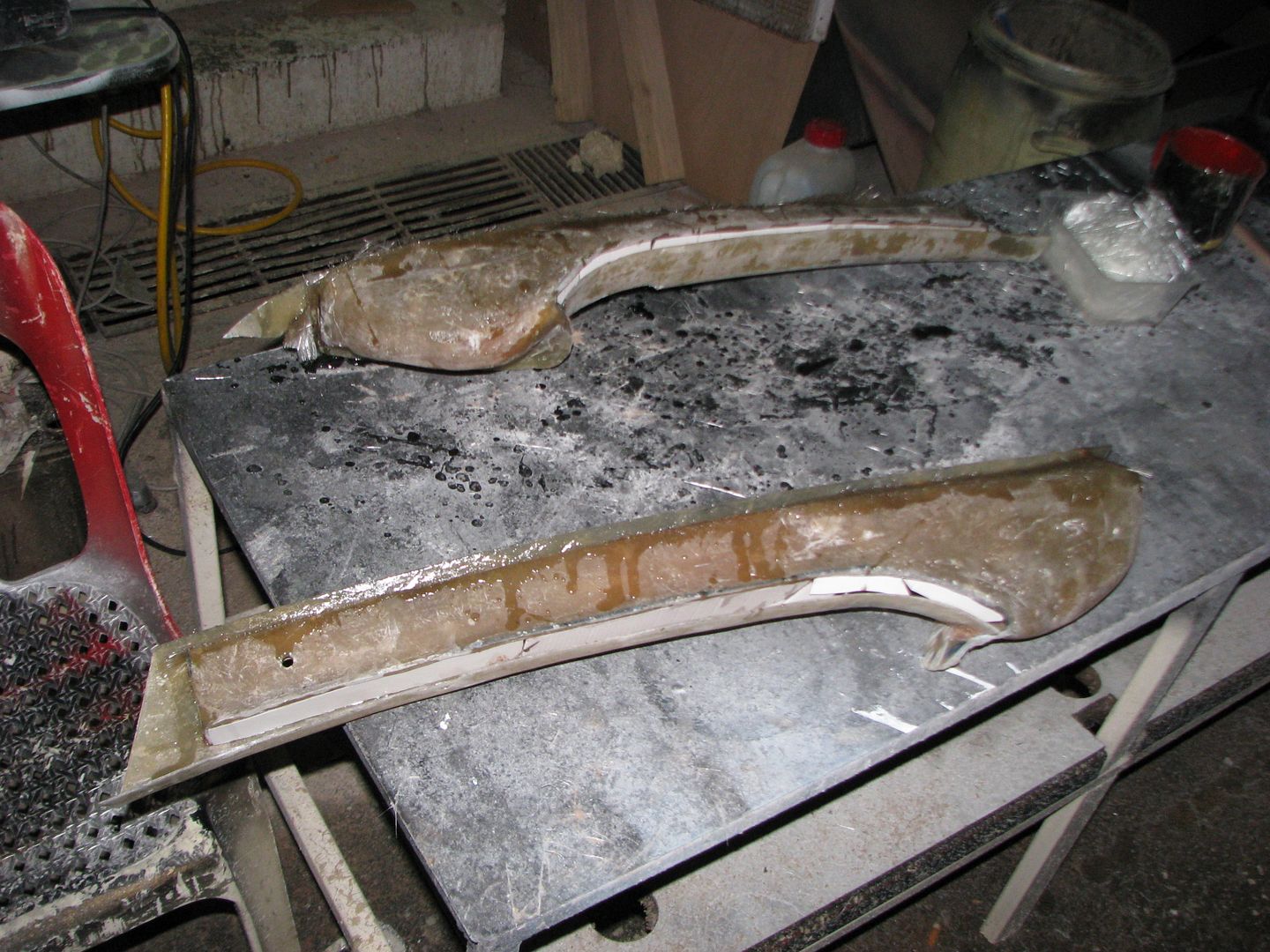

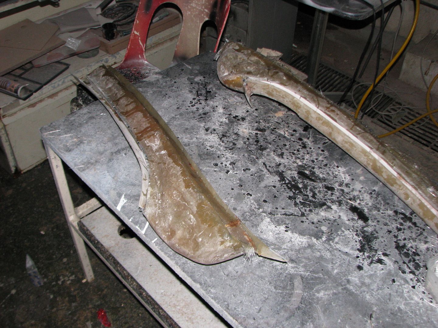

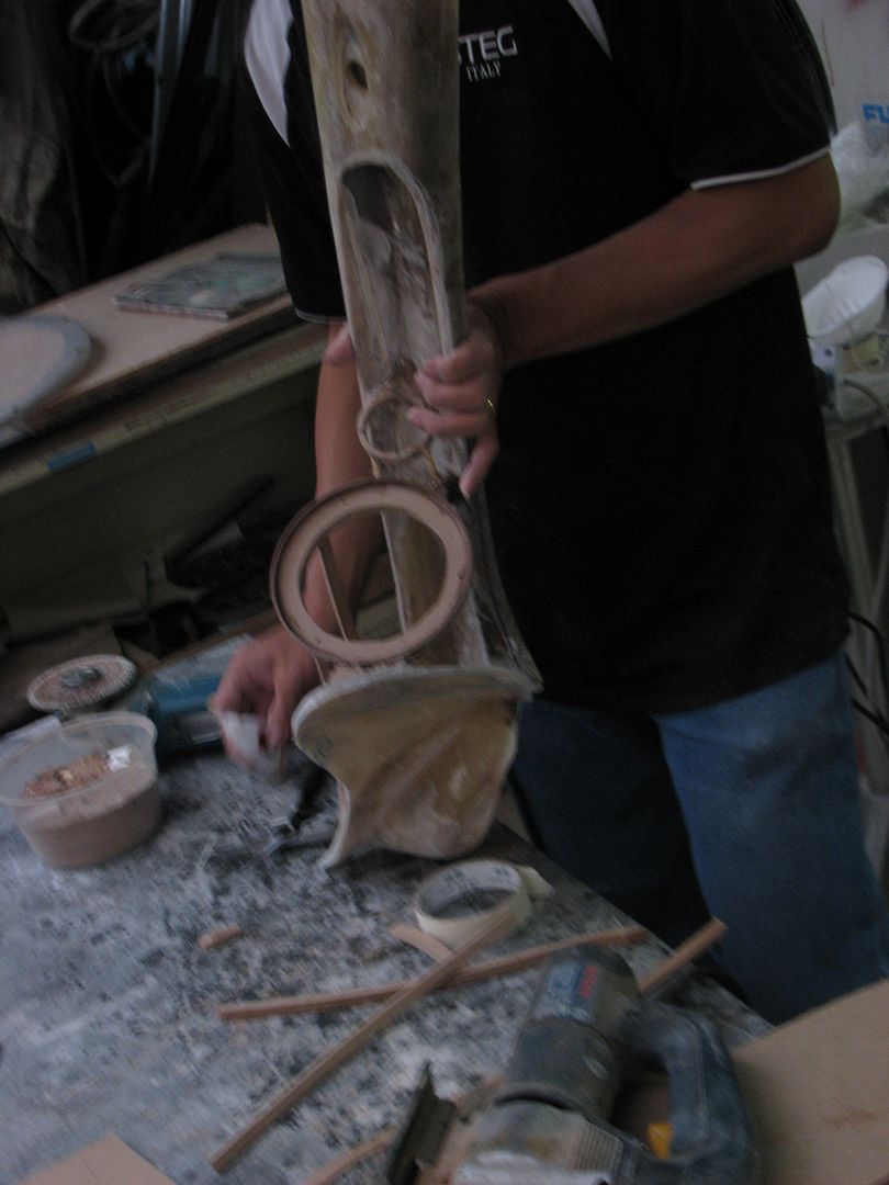

But what I do have are pictures from another fiat bravo, using the same exact speakers. The A pillars for the Comp car was built in the same exact way. So here are some pics to give you guys a better idea how this massive A pillar was built

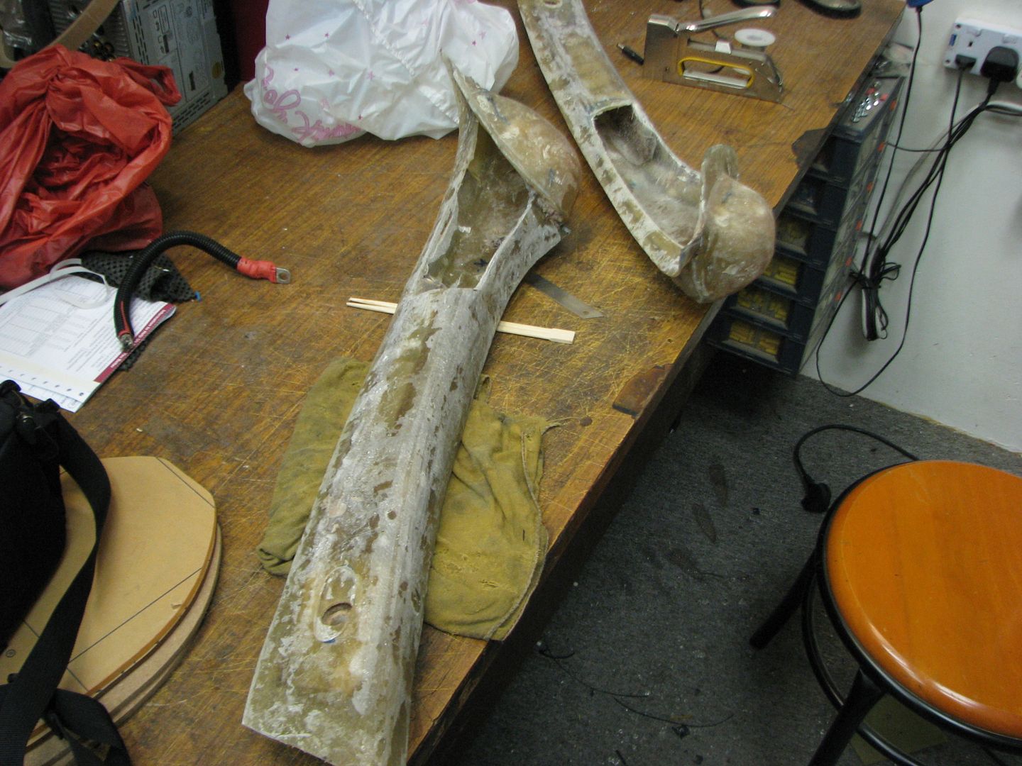

The original A pillars are taken out a mold is made
Carro foi enviado para a inspeção de hoje. Portanto, não há atualizações no carro.
Mas o que eu tenho são imagens de outro fiat bravo, utilizando as mesmas colunas exatas. Um dos pilares para o carro Comp foi construída da mesma maneira exata. Então, aqui estão algumas fotos para dar a vocês uma melhor idéia de como este Um pilar maciço foi construído
O original de pilares são levadas para fora um molde é feito

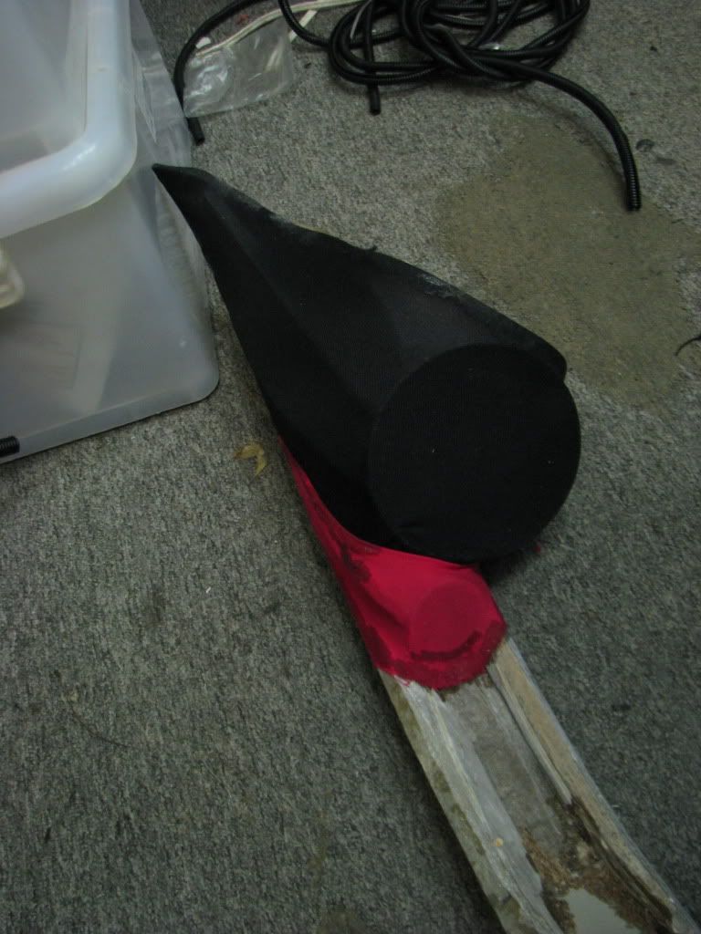

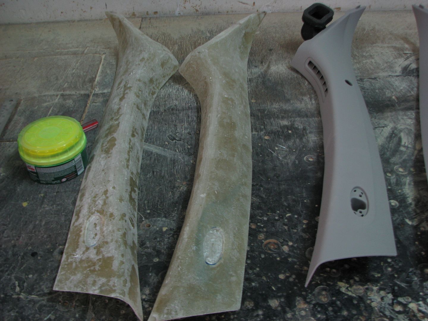

tadaa!
Instant A pillar!

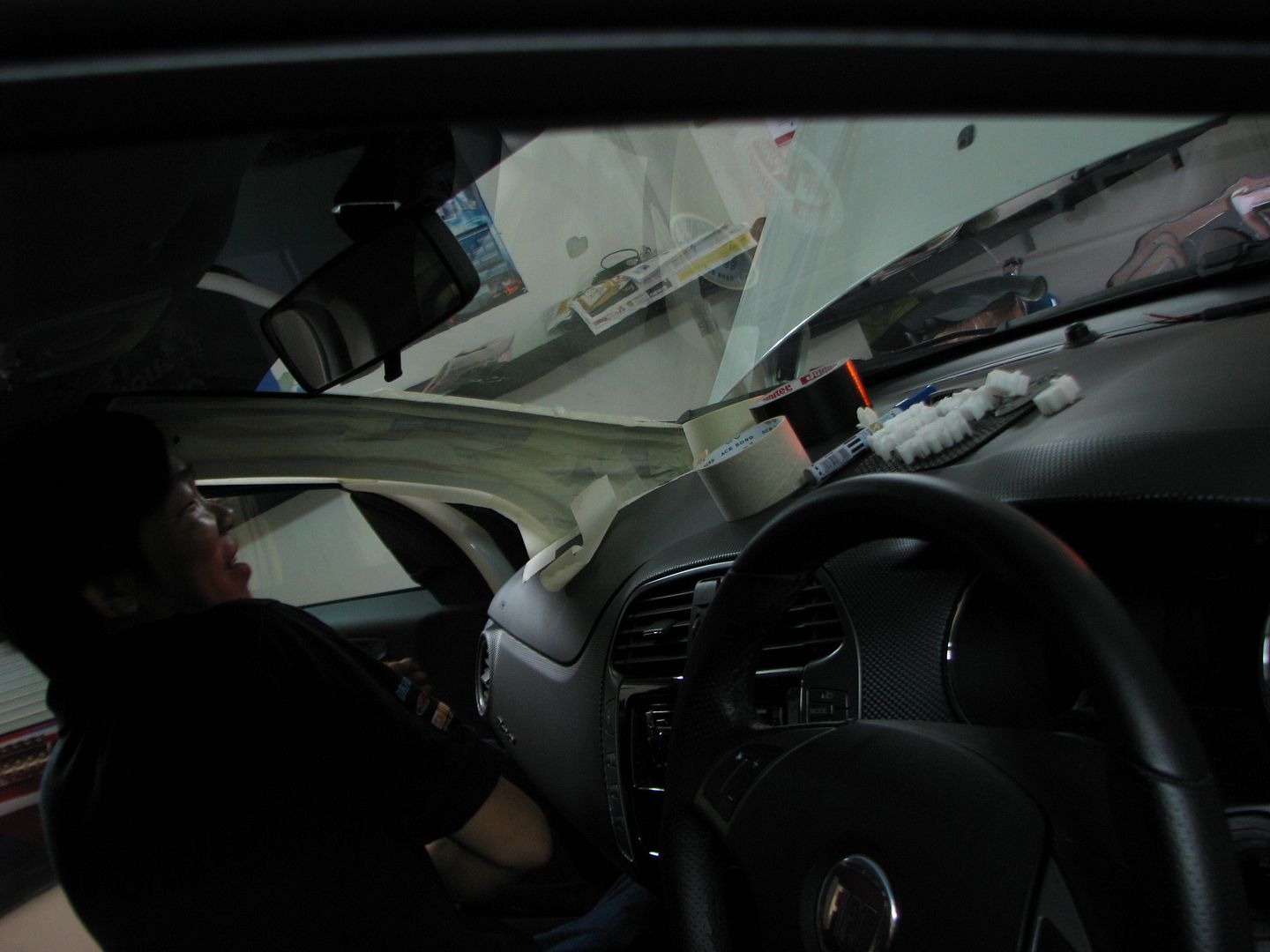

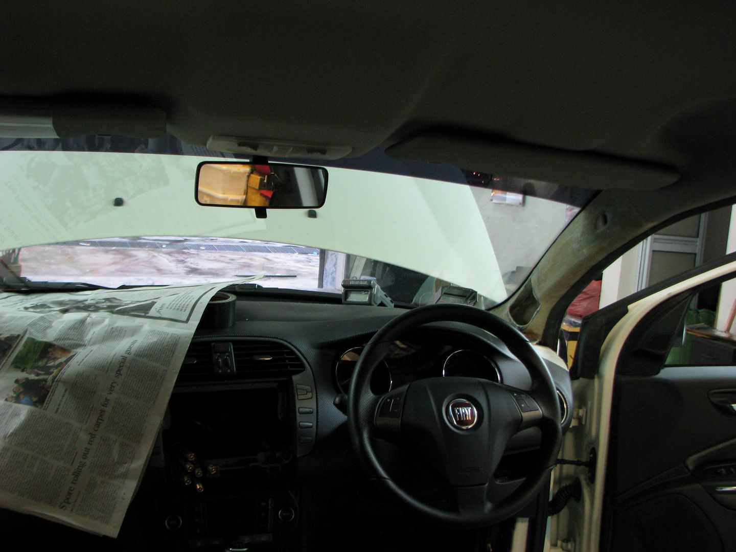

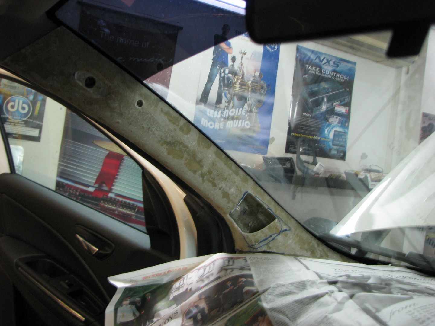

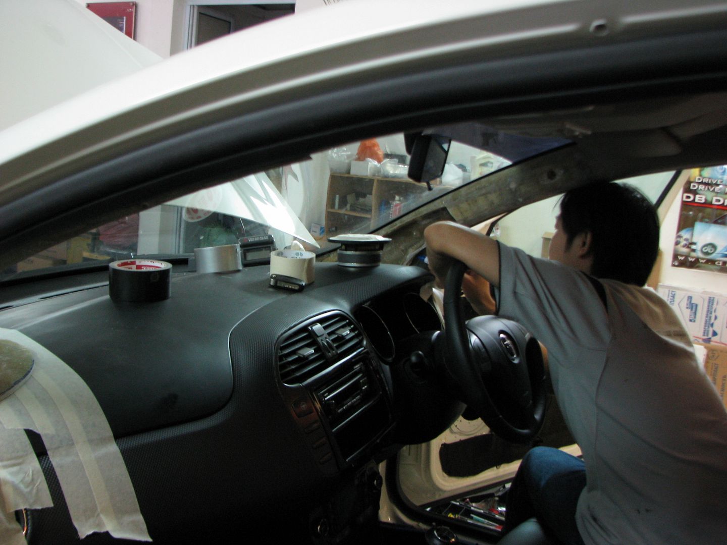

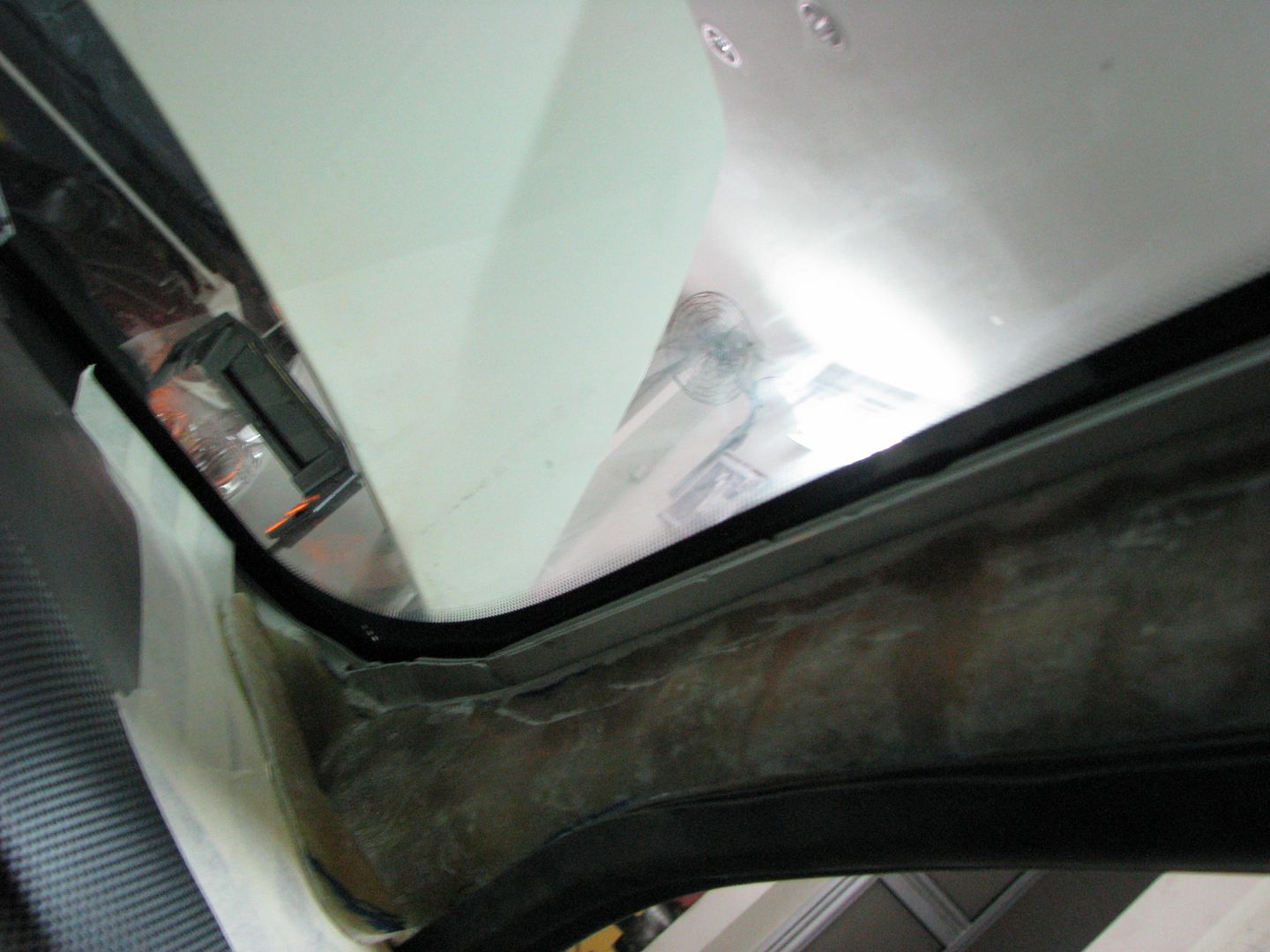

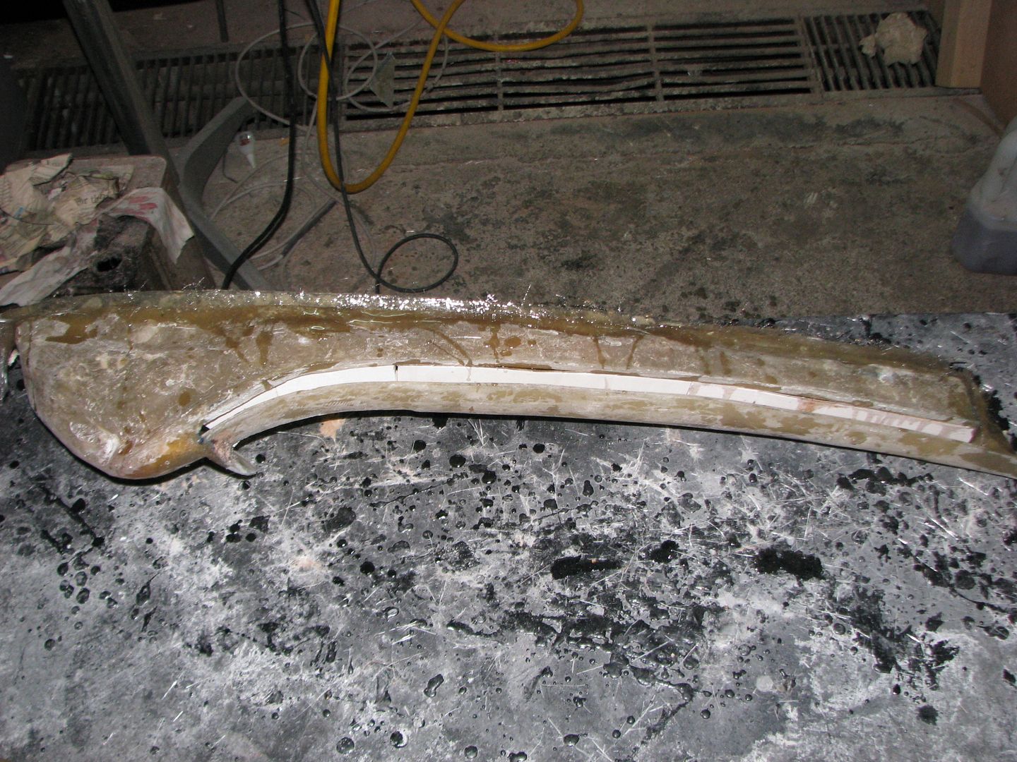

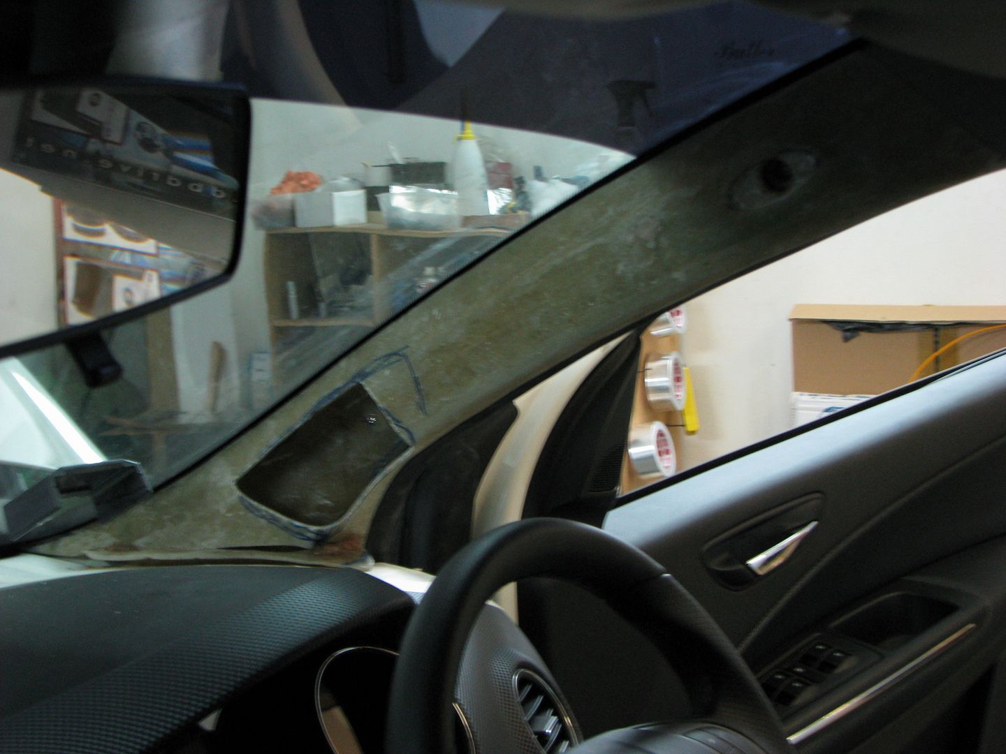

Now for the “ enclosure”.. have the car all taped up
now the fabricated A pillar is put on top
now the 2 pieces are taken out and put together
That’s all for today, more pics up tomorrow.. heheh..
Cheers all

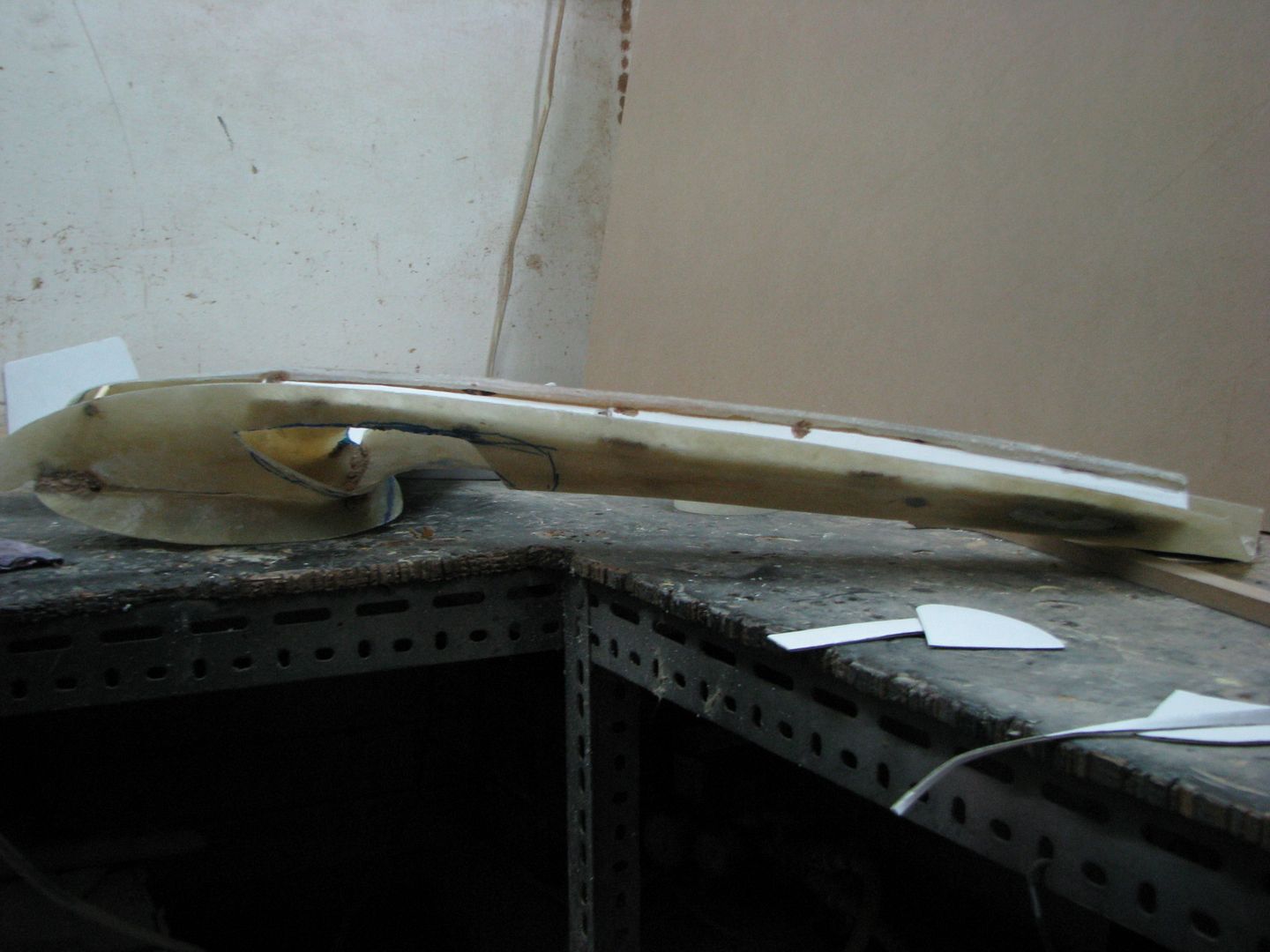

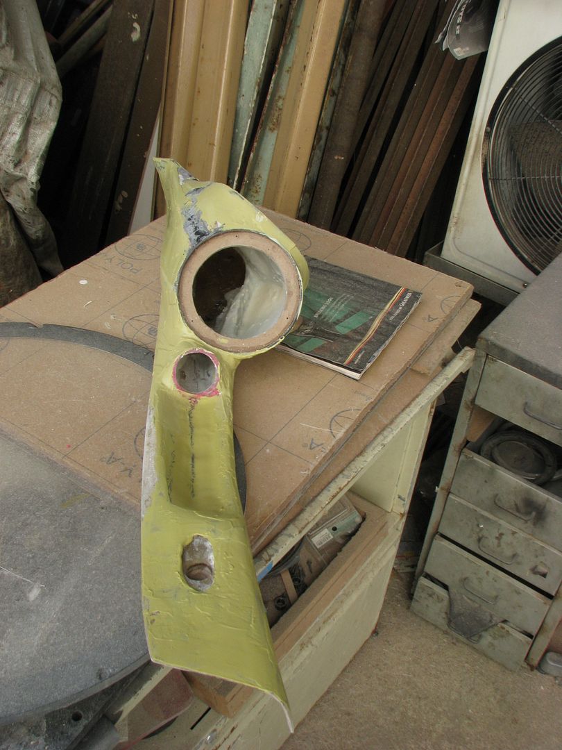

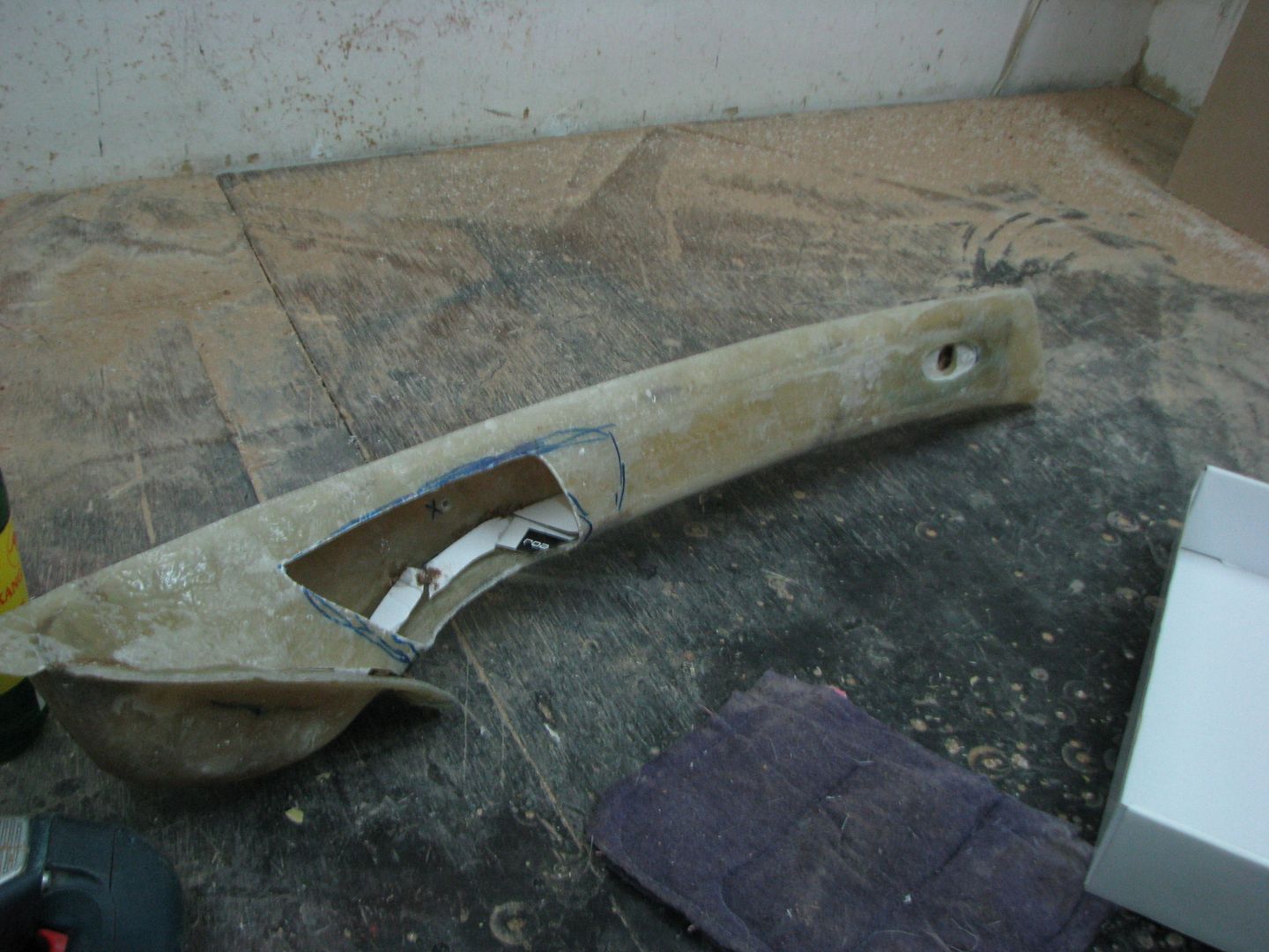

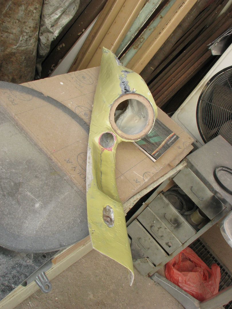

Here’s part 2 of the A pillar build
Now its time to seal off the “ A pillar”
and here we goooo

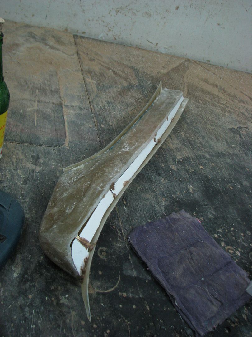

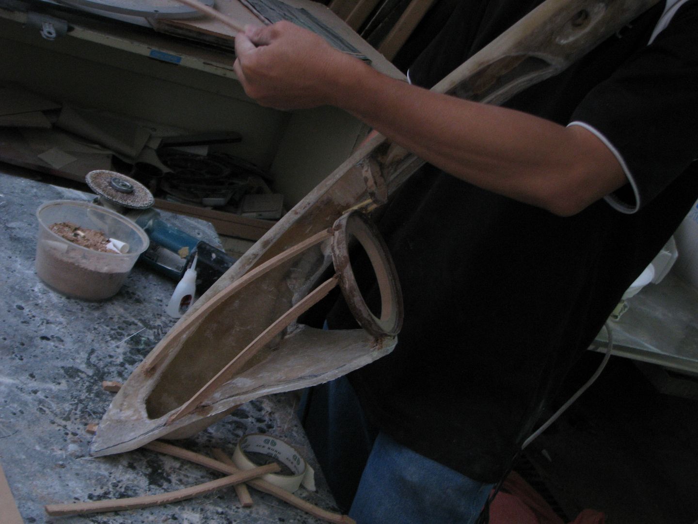

now this is the base of the A pillar. This is the part where the baffles will be mounted onto
taking measurements on where to put the tweets and 4 “
and here we go..
That’s all for today.
Cheers!

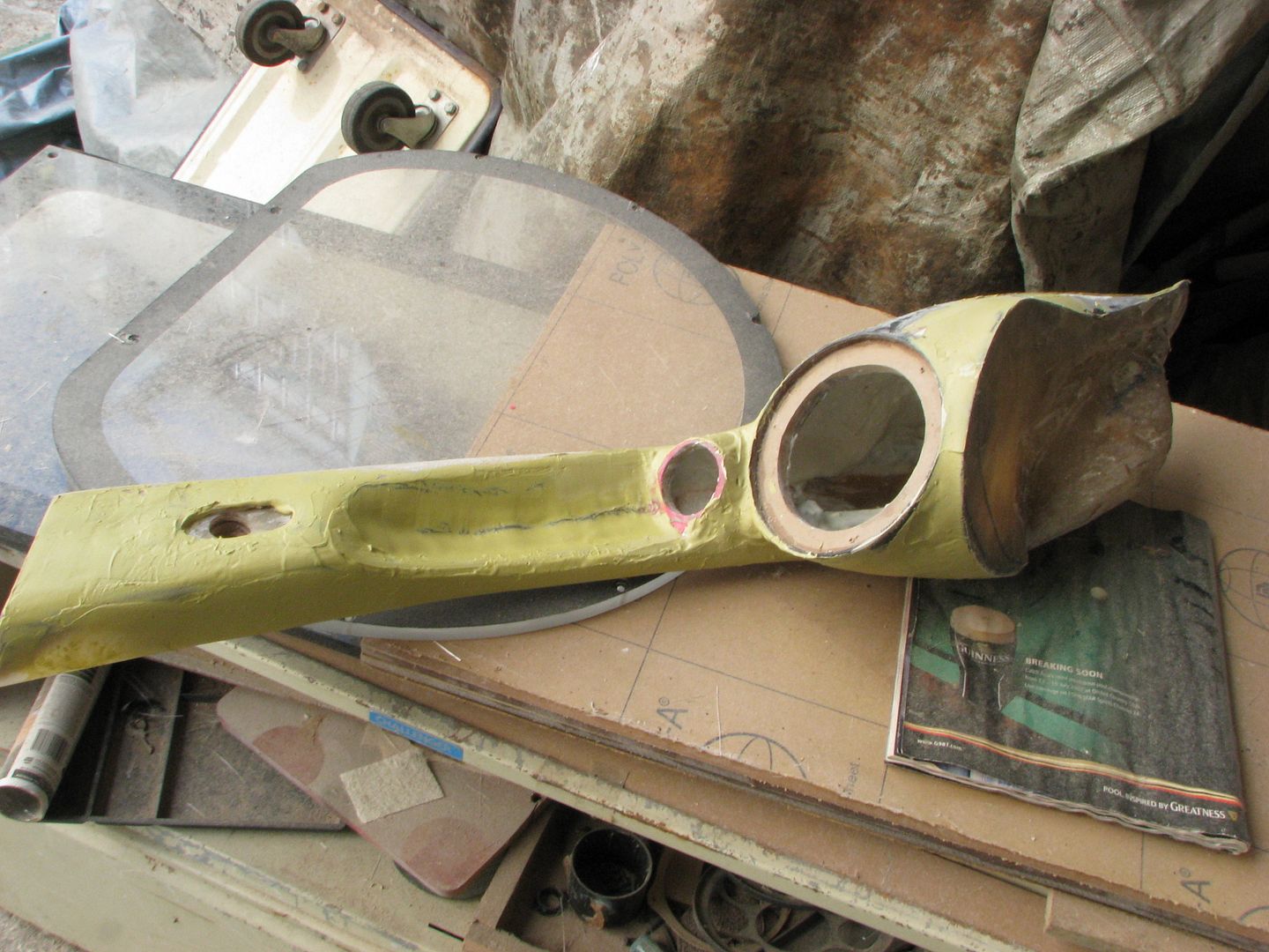

Hey all,
Now onto the last installment of A pillar build
Putting the stand offs on the baffles
what I like about this A pillar is the frame work. Its as though it has a skeleton.

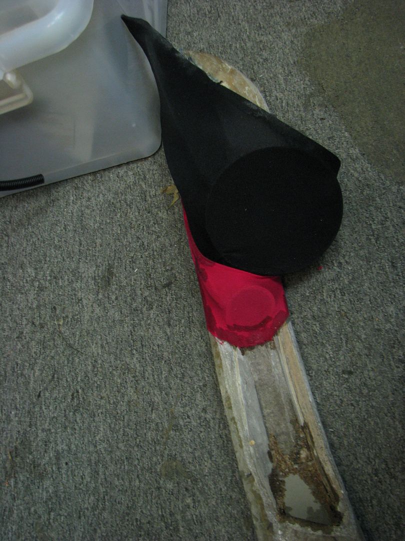

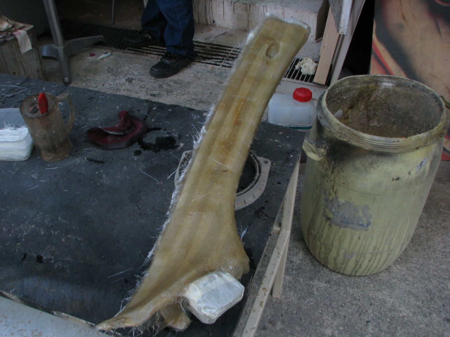

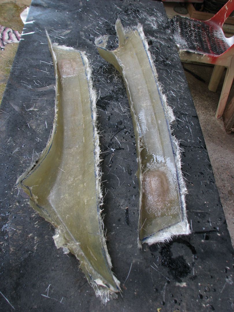

now to pull some fabric over

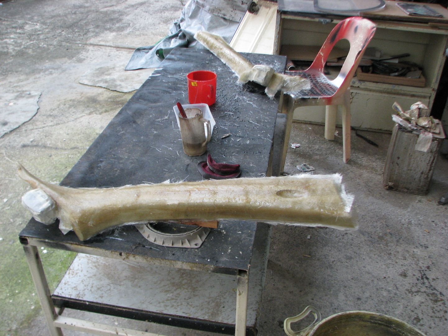

applying resin is pretty straight forward,
So here’s the end product
from here on, the A pillar just needs a shit load of sanding and its all ready 

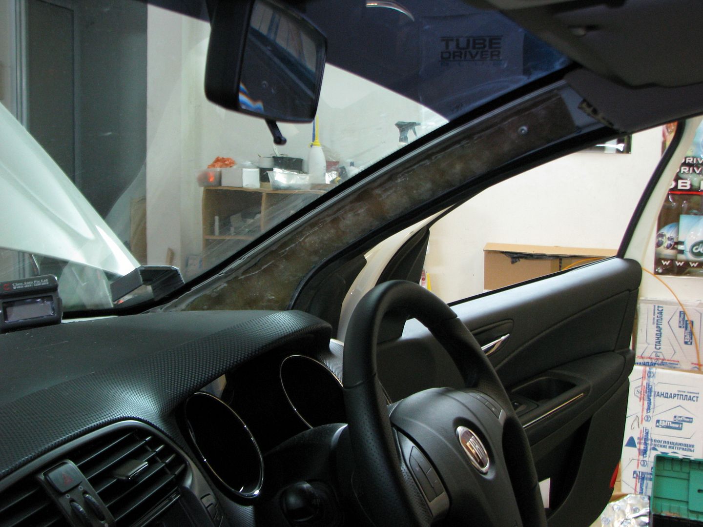

We got the A pillars in.
Here’s some close up shots of the mid range, EB tec LS 130
speakers in
