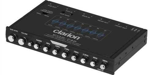

Estive pensando seriamente em adquirir esse equalizador e eliminar o uso de um player sem perder os controles do som:
  • 7-Band Graphic Equalizer 6-Channel / 7 Volt RCA Outputs (Front/Rear/Subwoofer)
  • Adjustable Master Volume Level Control Adjustable Subwoofer Level Control
  • 2-Channel RCA AUX Input with Adjustable Gain Selectable 12dB Low-Pass Crossover (60Hz or 90Hz)
  • Gold Plated Terminals Dimensions:7"(W) × 1"(H) × 4"(D)
  • This unit is exclusively for vehicles with a negative ground, 12V battery system.
